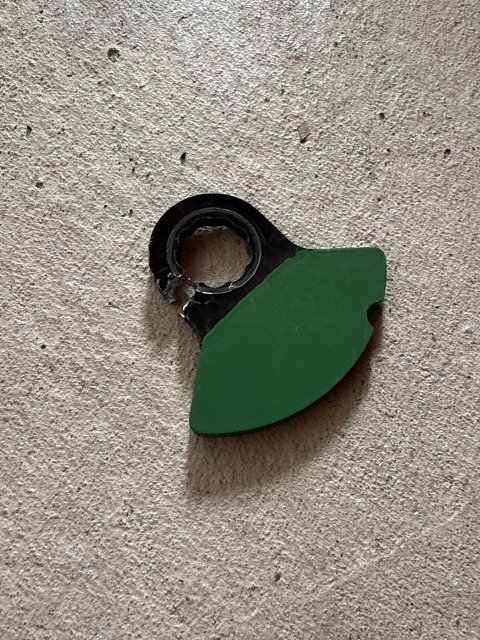

Who can tell me what this is?

I won’t say where it came from yet, but it’s on a Demon170 and there is more than 1 of them.

A nut locking tab on the rear suspension?

Looks like it took a bullet.

It’s the stock limiter plate, as shown in those instructions. They’re removed when you install the lockouts. Good job Linda!

BMR Cradle Lockout Bushings.
Look in these instructions. SCB110.pdf (bmrsuspension.com)
I bet @DGatzby would know about this!
I see he blew thru it to remove it.😝 I definitely recognize that little pain.
That little job is such a PIA, I’ll admit I paid others to bust mine out on both Hellcats.

It’s such an awkward looking piece. And unless you’re doing work on your cradle, largely unnoticed.

BMR are one of the few companies that make that lock out kit. AAD makes the adjustable suspension components (Great pieces btw) but not those limiter plates. And yes, in my experience they were not hard, but a pita to remove, had to drill mine out like in the photo. Breaker bar alone was not doing the job.

You didn't do it right, breaker bar works fine. The bolt has to be in so it doesn't flex and they pop off. Loosen bolt but don't remove and pry them off.
They have something to do with lining up the bushing when they are installed in the cradle

Guess I’ll save that little tidbit for the next time. Thanks vortecd.
