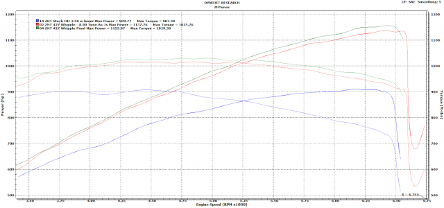

I've had my stroked Whipple for almost 4 months now and I couldn't be happier with it. However, my perspective is a bit unique given that I'm tuning it myself while also doing as much of the mechanical work as I can in my own garage. The journey of working through and figuring out all the issues is part of the fun for me. It's still a work in progress today.
My full build list is listed on my dyno and 8.90 videos so check it out there.

And here's my dyno graph comparing my previous stock block IHI 2.50 + lower pulley setup vs the built stroker with a Whipple.

Dam that sounds mean... 👍
