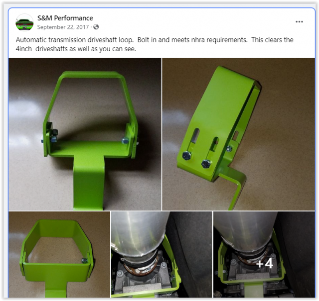

that's the same one I have, brand was "S&M Performance" at the time, although I am not sure who actually manufactured them; got mine from HHP also. I see they still have a FB page - might be worth an inquiry...

I run the S&M and it clears my Texas Speed headers and solo performance exhaust with a CCI 4-inch aluminum drive shaft without issue.
