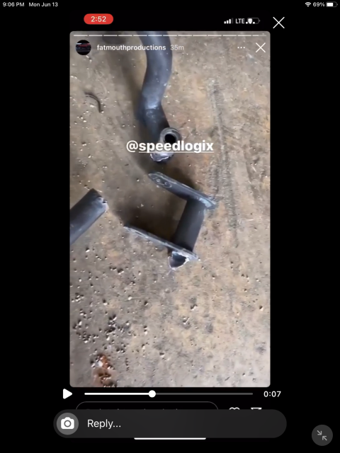

Below is a series of pictures posted by Challenger owners showing what they got when they purchased a Speedlogix K member.
The red k member owner recently posted along with a long description of the multiple issues the purchaser had, with missing bolts, grossly enlarged bolt holes, lack of brackets for oil lines, and most disturbing the quality of the welds.
Here is the link to the original poster's thread on another site. https://www.hellcat.org/threads/speedlogix-chomoly-challenger-kmember-k-member-review.253119/
The thread was written/posted by the owner of the red K member pictured below. The other pictures came from the comments section of the post.
In the comment section of this person's thread, other examples posted showing broken welds and shattered pieces of similar Speedlogix K members purchased.
Imagine installing one of these and taking your Challenger on a spirited drive on a twisty road, or launching it hard at the drag strip, and your K member breaks, like the black one and bare metal one did in the series of pictures below.
Why are people still buying from this company? Someone is literally going to get killed using one of these poorly designed and constructed parts?

Ouch. Even I can weld better than that.
But i'm sure they got a great deal!
Please tell me those were from china. If not... america is in a sorry state. Obviously there are Americans that make junk and pawn it off but I'd like to think they were in the minority
