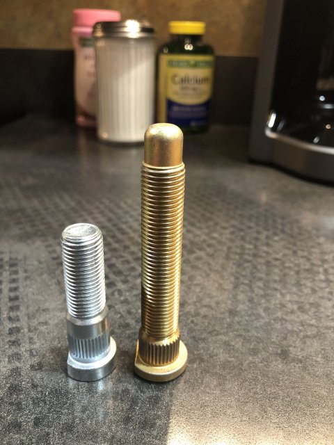

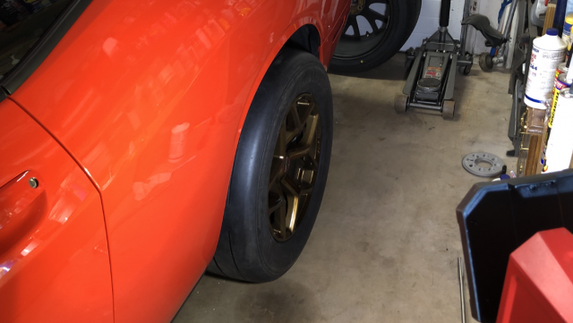

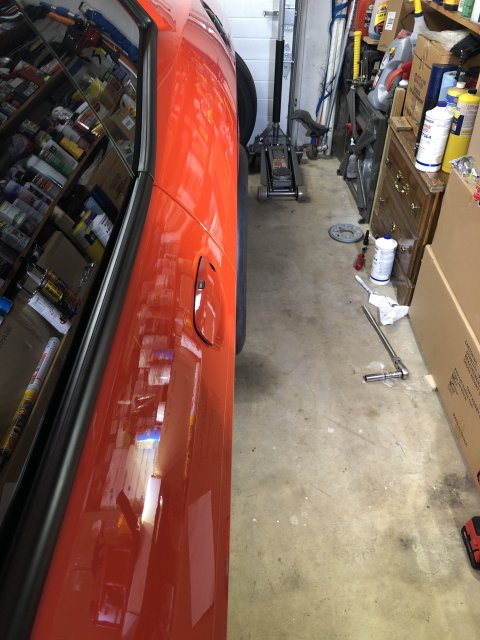

43EFADC2-BD15-456A-80AF-4F87CA2EA0AC.jpeg B68B6BA2-9662-4051-9AC8-2FDE3A241C50.jpeg 848540E5-5B84-4203-8B6D-BCD09CFE8797.jpeg A824CCA4-14D2-4DB5-A2E0-A9391A5E306E.jpeg
Finally got to the spacers, went back to stock wheels cause even with 305s they rubbed. Plenty of space. Meaured depth of the stud with spacer then went and measures depth of stock lugs to see if they would seat right. Very happy with the Dorman lugs. 315s are on their way and will get those on next. Since the lugs Im using on the D5s are open, don’t have to worry about meauring for those.

View attachment 62346 View attachment 62347 View attachment 62348 View attachment 62349
how wide is the spacer ?...looks like 1/2"
315's are ya ?

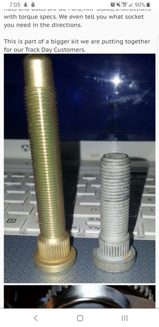

These correct? ARP on right, Stock from the dealer on left, they correct? Shoulder is shorter, will they work??
I would not use a different configuration. Even the rounded end looks like crap. Probably made in China!
315's are ya ?
Spacer is 12mm, tad under .5”. 12.7mm
Is .5 on the nose. 315s were what I tried last year but because of the backspacing of the D5s they rubbed. Right now I have 305s on that rubbed previously and now they are not rubbing. Very happy.
Nice work, brother.
