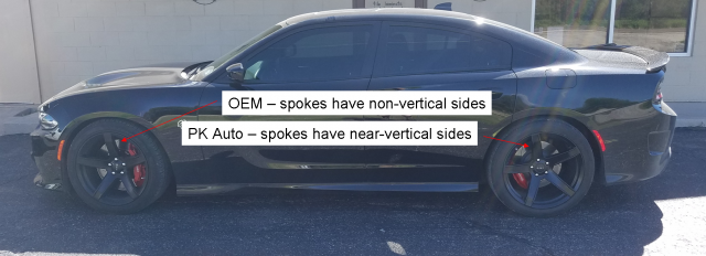

OEM up front (with a spare set that came off the rear) and Paul's 20 x 11 (21 off set) in the rear.

No, the out of rounds are the OEMs that were on the front (still run 275s up front). The rears I pretty much love. They look nearly stock (the whole point) but allow a full wheel width 305 or 315 to be used. I'd love a 345 but I think that's pushing it without modifications to the wells (and they don't make those little eyebrow wheel well archs for the Charger....).
They're not undetectable. See here:
To casual observation you just look like you have a set of stocks front and back.
