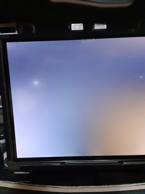

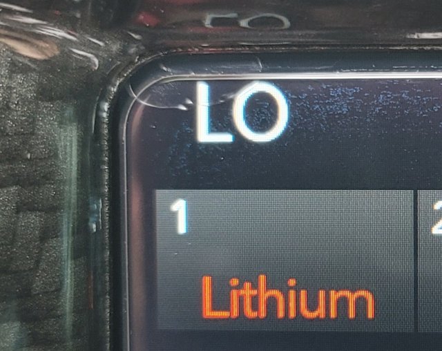

Just noticed my uconnect screen in the upper left hand corner is bubbling up underneath the screen, I have heard of this happening to others, anyone in here experience this?
Just figures, I just got my dash hydrodipped and now it needs to be removed again to replace this POS Uconnect head unit FML!!
Just the thought of having to go to the dealer makes me sick, thank God for extended warranty! Screenshot_20210613-105328_Gallery.jpg

There is a screen protector on it yes but if you look closely the protector is smaller than the actual screen and the bubbles go past the screen protector, just noticed top middle is also bubbling ugh...
This uconnect screen is toast, dealer visit this week UGH...

Happened to my Durango (also an '18). Defect in all the screens manufactured for that model year & FCA is covering it, even for original owners who are out of warranty.
It seems to primarily be an issue in hot/humid states, so your NY dealers have probably not see/dealt with a lot of it.
You may need to call Dodge & get them involved.
The bubble will spread & eventually the screen begins to take on a life of it's own, activating 'buttons' randomly :rolleyes:

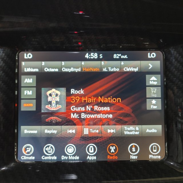

It's already getting worse, here's a picture of the screen the bubble in the middle has gotten bigger since yesterday, going to the dealer tomorrow so they can look at it. Resized_20210614_105945.jpeg

Mine was just like that, the 2 bubbles eventually joined up & that's when the screen began acting like it was possessed !
Took almost 4 weeks for them to get the replacement unit (late last fall), install was about 1 hour.
