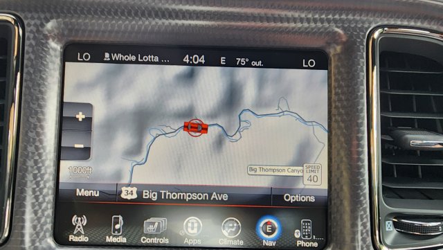

Update:
Upgrading from 17.11.07 to 18.45.01 fixed the clock... ...now lets just hope there aren't new and exciting things to worry about with 18.45.01... : (
Clock being off was ine of the reasons they developed 18.45.01. The initial release of this ota update bricked many Nav's. Mine included. I had to wait for the usb to arrive, before I could fix it.
