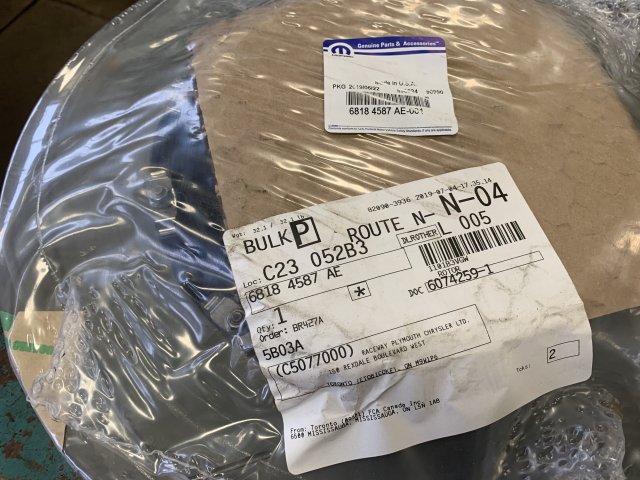

Had my rotors replaced under warranty. 818C5781-C9FC-445D-85CD-195EC47427AE.jpeg BD99D1A1-9653-45DC-9997-6C2004EA8D06.jpeg

My rotors were replaced under warranty for pulsing upon braking application.
The new rotors began to do this click sound as soon as l got home. I went to this site and found what others had done with the click and followed suit. I took off the wheels, scotch-brited the rear of the rims a bit voila! No more clicks, been 2 years...
Had that not worked, I would've followed up with the dealer again...
