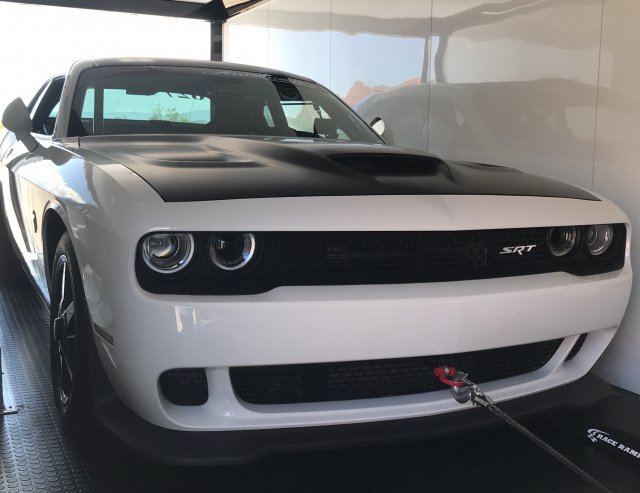

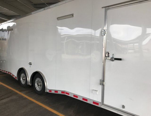

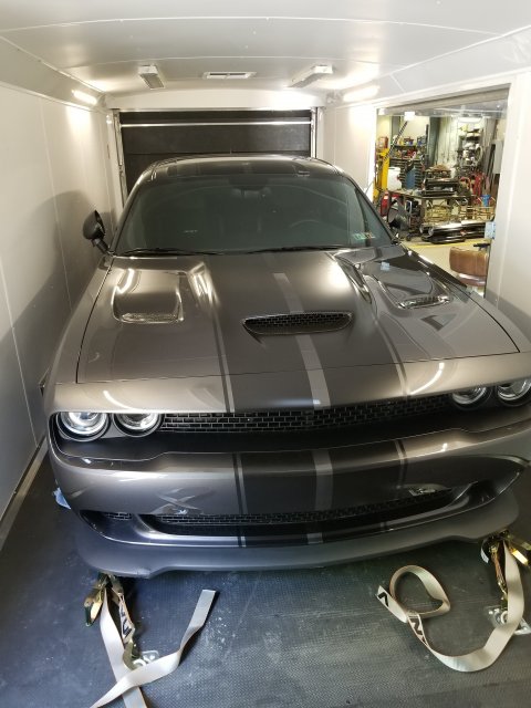

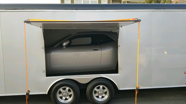

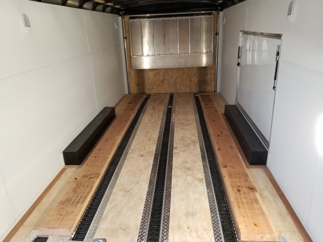

Used enclosed car hauler/race trailers in decent condition are near impossible to find. That being the case, unless you’re lucky, you’ll have to buy new. If you opt to order, it’s surprising how inexpensive adding the escape door is. If you find one available on the lot that doesn’t have that, there is another option than most don’t realize is very easy and safer than driving up and into a trailer. A winch with a nylon cable. You can add a tow ring to the front of the car (they are removable) and once you get the procedure down it is easy. You will never need to get into or out of the car in the trailer. F5C401B1-6497-493A-8B04-DBF04C2150A0.jpeg A7A6FFEC-DCB3-4A4E-9BE9-3B7600A71402.jpeg 4E8FA96F-AB65-4A95-BF16-B5420B45C4F7.jpeg

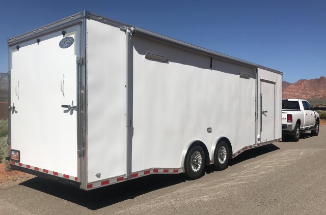

This trailer was totaled in two successive hall storms, but this is how I dealt with clearing the fenders on a steel trailer.
Right now I'm looking for a new Aluminum trailer to replace it, but they're not easy to find in the configuration that I want.

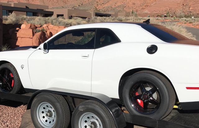

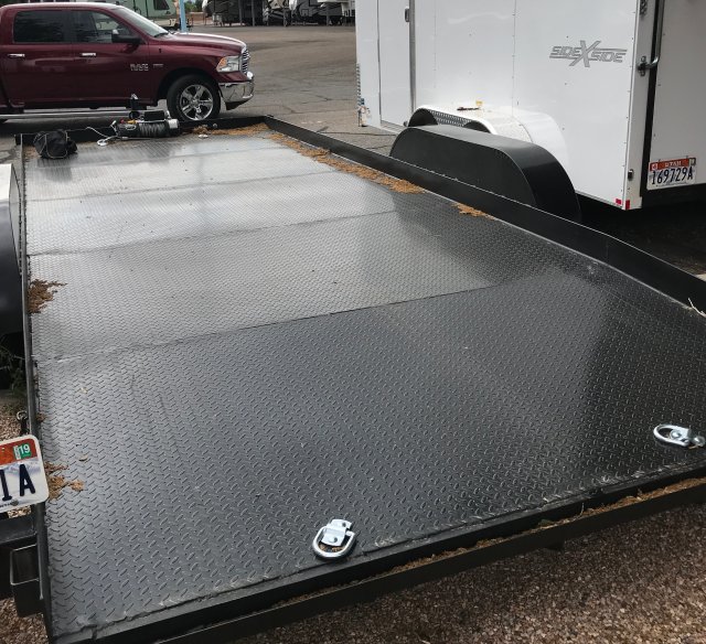

0CEBB3E7-D8F5-475A-9C4A-048E34127411.jpeg 281B5940-C1AF-4CC5-983B-9DCD2489910E.jpeg
Unless the 'Cat's lowered, the door should easily clear a typical trailer fender.
My 18’ open car hauler (48” dovetail) before moving to the enclosed. Car door did not clear the fender.
Figures. Mine are removable, but do clear the door.

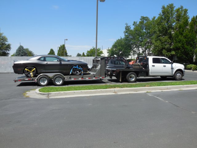

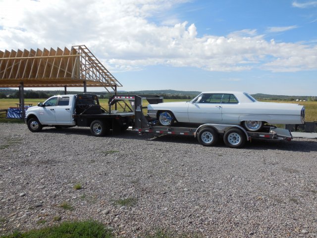

In both cases the doors cleared, but while the Caddy was just driven up, the 'Cat required a fair amount of stacking 2x4s and even lifting the front of the trailer up by about a foot above the coupler. DSCN2112.JPG

In both cases the doors cleared, but while the Caddy was just driven up, the 'Cat required a fair amount of stacking 2x4s and even lifting the front of the trailer up by about a foot above the coupler. View attachment 25666
Damn! That Cadillac looks like it's the heaviest piece there... :oops:
6,289
11,775
Not quite. The Ram is at about 9,300 lbs.
It was a tow filled two days, taking the Caddy to my dealer in southern Utah, then a dealer-trade Jeep to northern Utah, load up the 'Cat and head home.
That looks like a short beavertail section. Mine was the last 4 ft which helped with ramp angles and such.
Yeah, it's only two feet long. Didn't really have Challengers in mind when buying that trailer.
Have since bought a 32-foot gooseneck with a 10-foot hydraulic dove tail, but have yet to measure/try if the angles will accommodate the 'Cat.
