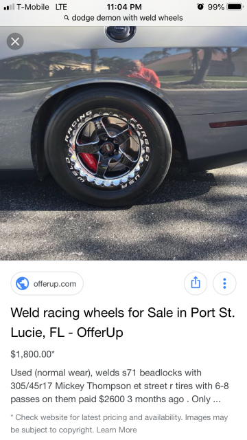

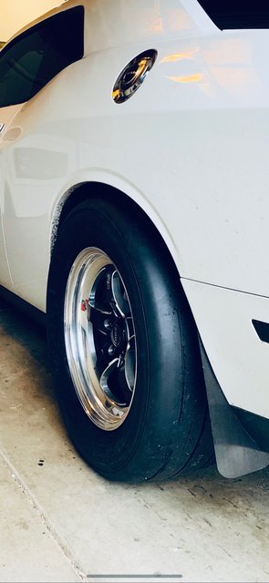

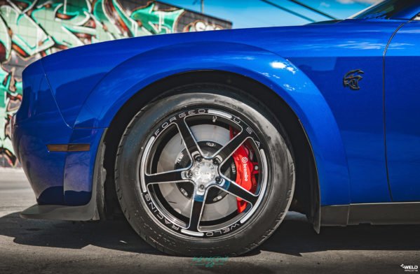

Agreeing with above. It’s what i have on order. 17x10 Weld S71 Beadlocks and M/T 305 ET Street Rs. On the front new 18x6 Weld Alumistars and M/T Sportsman S/R skinny’s 28x6.
Attached are a few pics to give you an idea.
