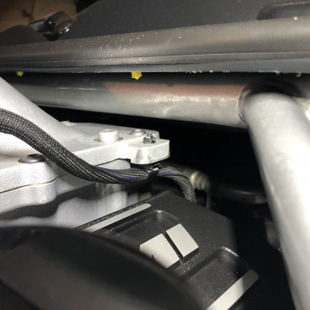

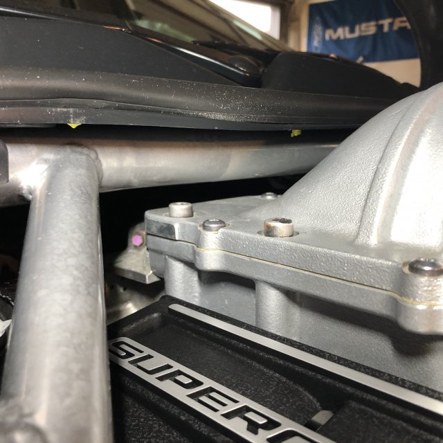

So you can't run the spacers and shock brace together?
It might depend on what brace ?... but my Speedlogix 4 point strut tower brace fits with FI spacers still with 1/2" gap & even racing it & engine torqueing over it doesn't hit the brace.
