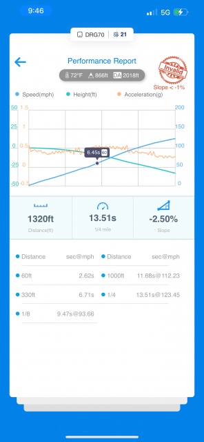

Baseline run: the baseline run was a 13.51 1/4 mile @ 123.45 mph. This run was invalidated because the slope exceeded the allowed amount, however the run for data purposes is valuable. I tried rolling on the throttle from a dead stop but spun all the way through third gear. I had the car in street suspension, track traction control, transmission in normal (tuned for increase shift pressures, lower shift times, etc).

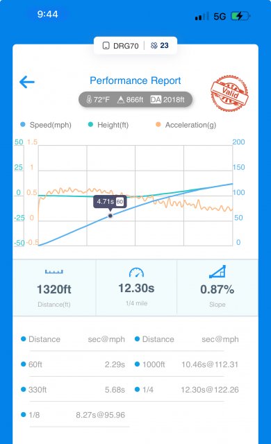

From previous testing, I decided to use the launch control. RaceTCS has made the launch control useable. I have the launch control set to 1500 rpm. I was able to run a 12.3s 1/4 mile @ 122.26 mph. The run was greatly improved because of RaceTCS. There’s definitely some room for improvement in the 0-60 foot range. But in order to be able to leave out of the hole harder, I need a better tire.
