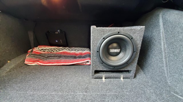

I have subwoofer in the truck with an amp, what are you concerns? 20200621_182903.jpg

I replaced mine with this and it sounds like a washing machine. CCDF4A73-A704-4674-A06F-23ABD2D0EF70.jpeg
