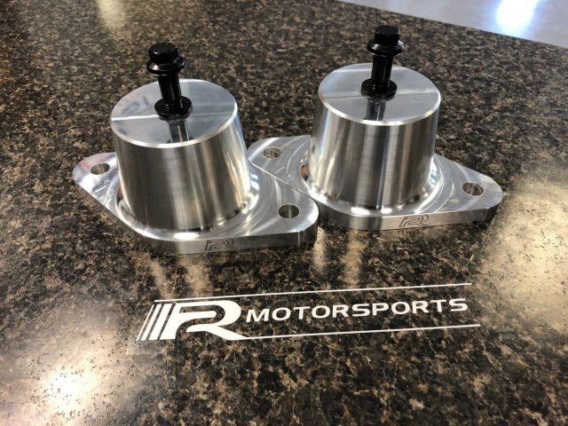

Has anyone here installed R2 Motorsports solid motor mounts?
If yes what are the pros and cons?

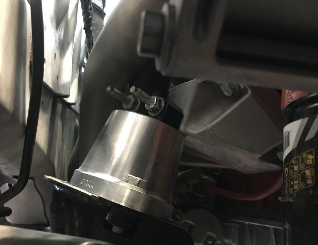

8,512
7,441
If you run solid mounts you’ll find the weakest link in your drive train. Some of this stuff helps lessen the blow.
