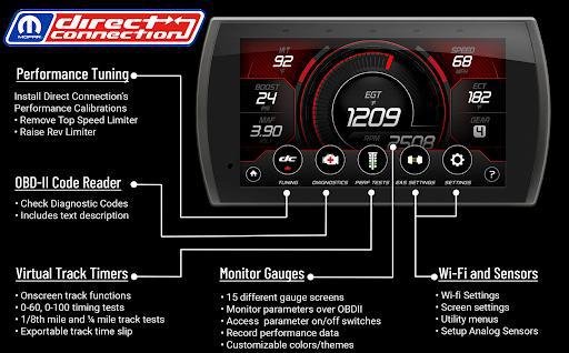

What ever happened to the Direct Connection tuner, which I believe is a Diablo tuner. Full warranty maintained and i don't believe a new PCM ia needed?
Of course it might still be vaporware even though it was announced ages ago.
