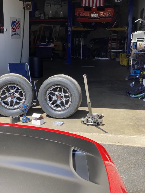

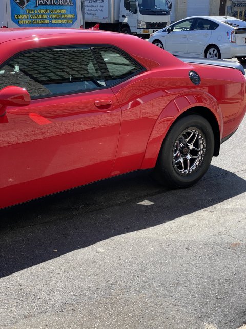

Guys, drag pack rear tires rubbing slightly “inside front” portion of the plastic wheel wells, just enough where it’s down to metal..have track event 4/20. Thinking a spacer? Suggestions on good product please. TIA

I bet you have the wrong rims. With 5.25 back space you should not be close to anything even with a 315/50R17. Looking at that pic it looks like you have the wrong rims.

I do. Im pissed Ron!

They sent you a Drag Pack rear wheel. Those are only made for the Narrow Body. Drag Packs were never built on a Wide Body.
If your invoice says "Dodge Wide Body Single Bead Lock Rear Wheel", then they definately sent you the wrong wheels.

Absolutely will work. 17X10 with 6.5 back space Billet Specialties Win Lite Drag Pack. You are golden with a 305/45.
