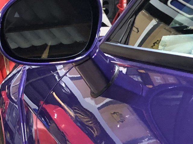

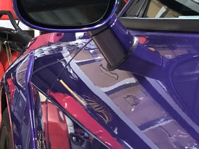

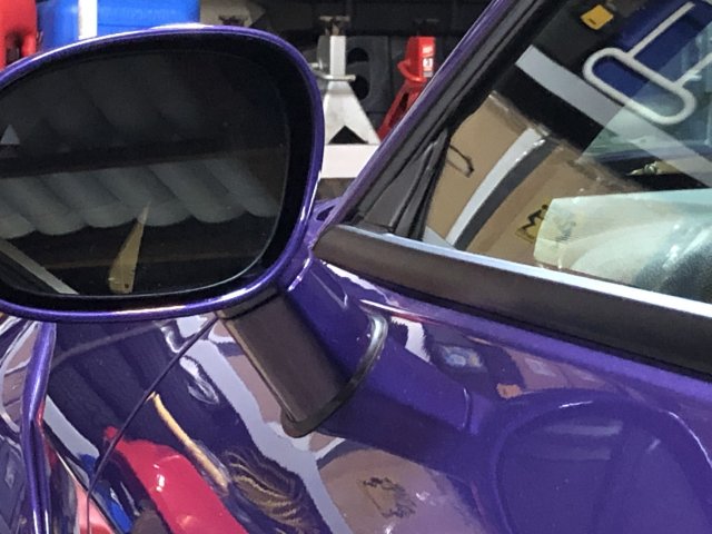

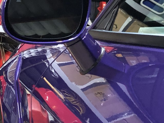

I’m using the horizontal beam from a storage rack in the background and the reflection off the paint to show the extent of the ripple / die mark under the DS mirror (similar concept to the lighting the PDR guys use to find dents).
The beam is straight but the ripple makes it appear bent in the reflection under the mirror.
I apologize in advance if this brings similar issues to light on other people’s cars.
I’m just trying to gauge whether I should do something about it (PDR) or accept it as a know issue that really isn’t hurting anything.
Eric.
