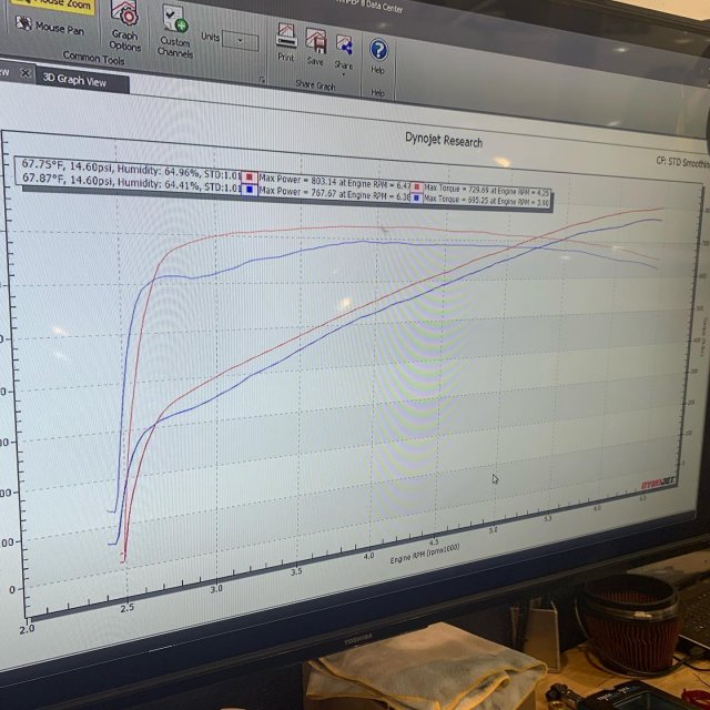

Cool. can you post the complete mods list? Also, have a shot with SAE correction by any chance?
I do not use SAE correction here is why. At the race track we rely on our weather station to measure gains and losses through STP correction. Using the dyno measurements and the track data in the same format lets me know what to expect and give people real world performance predictions.

What's the difference between the HO and your standard tune? How close are you running it to "suicide" levels?
Not close at all, in reality far less close to suicide than just bolting on a pulley blindly with no tune. In non Ho mode you are still good for 91, then with a press of a button HO mode is activated optimized for 100 octane fuel that nets a 40-50 whp boost.
