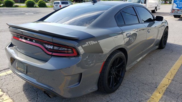

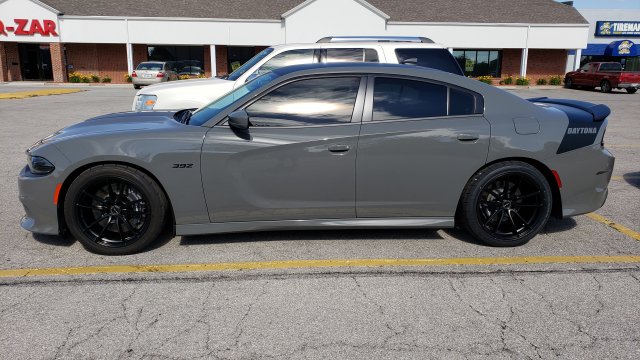

275 is the widest you're supposed to go on a 9.5 wheel, which even on a SP isn't enough. I had 20x11 w/ 305s and it definitely hooked up a lot better. If you're going to invest in a complete set of new wheels anyway, why not spend a few dollars extra for some improved summer grip too? 20190628_171710.jpg

275 is the widest you're supposed to go on a 9.5 wheel, which even on a SP isn't enough. I had 20x11 w/ 305s and it definitely hooked up a lot better. If you're going to invest in a complete set of new wheels anyway, why not spend a few dollars extra for some improved summer grip too? View attachment 42333
Looks great. Any rubbing issues?
If you don't mind, what is that wheel/tire package?
Piening2150
#1025
787
1,750
Toledo
2017 Charger Daytona 392
No rubbing at all. Wheels are Velgen VRF5, tires are Firestone Firehawk Indy 500
Front 20x9.5 +18 offset w/ 275/40/20
Rear 20x11 +22 offset w/ 305/35/20
315/35 would be exactly the same OD as 275/40, but the Indy 500 was only available in 305/35. It's only about 1% different, and I already had new 275 Indys on my OEM wheels when I got the Velgens, so I stuck with them. If I was buying all new tires I'd probably go with Continental DWS or Extreme Contact in 275/315 sizes.
