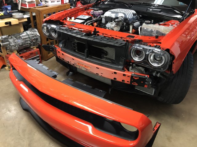

Do you have to take off the bumper cover to get to the stock motor to remove it?

You may be able to get to it taking the belly pan off. I would look for videos of taking the bumper off and you may be able to see if it is possible

Already upgraded to emp rear trunk kit. Mechanic left stock motor in. I want it out.

Easiest way is take the front cover off, you end up taking bunch less apart doing it that way. Cover only takes about 45 minutes to remove and then the pump is right there 4 bolts and it’s out.
