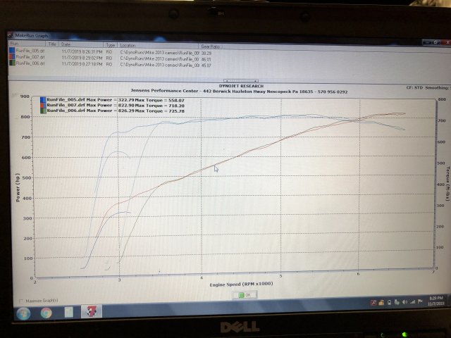

98B54A6F-BE90-4F3A-B15F-D3DF47D3E930.png I’m making around 16.75 to 17.25 lbs of boost as well. I’ve switched to this supposed O2 sensor and Cat friendly VP Octanium, 1 qt in 15 or so gallons of 93 should make for 96-97 octane and track time a Qt in 10 gallons of 93 supposed to whip up 100 octane fuel. Torco type results in a sensor safe mix, sounds maddish even. But Knock sensor volts in a next to nothing 1300 milivolt range and even bank to bank at 6500 rpms and 17.25 lbs of boost is saying engine seems very happy running it. And I run mine hard at least one 1/4 run every time out, 11.5 1/4’s on dusty cold asphalt in the dark 392C0687-CD56-42FD-A39E-EA7E2682A690.jpeg ain’t bad around here in February :)

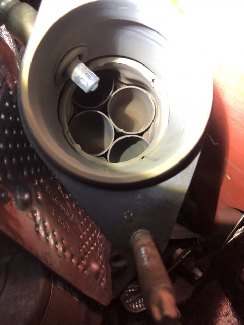

Funny you ask such as I had the same curiosity myself and pulled two after running it hard for 3 tanks of fuel now and about 20 1/4 runs. Here’s 2, one from 2 and one from 7. This was running 1 qt of Octanium and 10 gallons of fuel for a 100 octane blend. Dropped the exhaust too, here’s the O2 sensor and Inside of header, for a 100 octane mix Boostane and Torco would be much worse at that blend. I like this stuff so far.

PS, These plugs have about 4500 miles on them, most of it on Boostane , I’ve seen them darker orange then this, they look like they’ve actually turned less orange then last check.

Nice coloring. They are a mirror image of what the plugs in my BBC used to look like when I ran 93 and a can of the N.O.S race fuel additive. (Black can). I guess they all use the same or similar chemical additives? They used to advertise it had nitro in it but I think that's all BS and marketing. I didn't care because it really worked. If I did a full run and hung it out to 6500/7000 on straight 93 I'd have oil on the valve covers from blow-by. When I added the N.O.S and did same run, almost zero blow-by. I honestly would be skeptical of sensor safety long term though. All looks very clean though!
