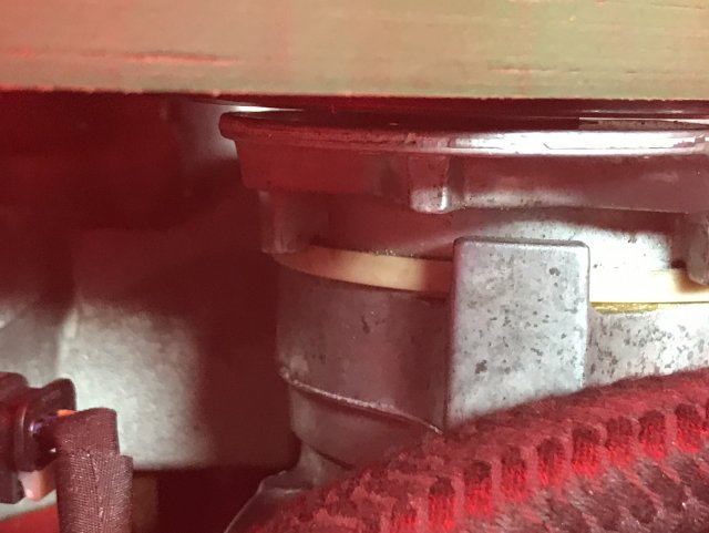

I’m in the process of replacing the idler and tensioner pulleys on my Redeye like I did on my Hellcat. TBA sent me 2 idler pulleys. When asked why I was told since it was basically a Demon motor it needed 2. The guy says his Demon needs the 3 pulleys. WTH???
I have one idler and one tensioner pulley. Someone help me out here.
additionally the Redeye tensioner indicator reads about at the same location as my Hellcat after the 2.85 pulley swap so, what is the size of the OEM Redeye upper pulley.
See attached photo of tensioner position indicator. (Note the photo is upside down.

OK, the 2nd idler pulley is on the black belt not the green belt. Silly me :).
