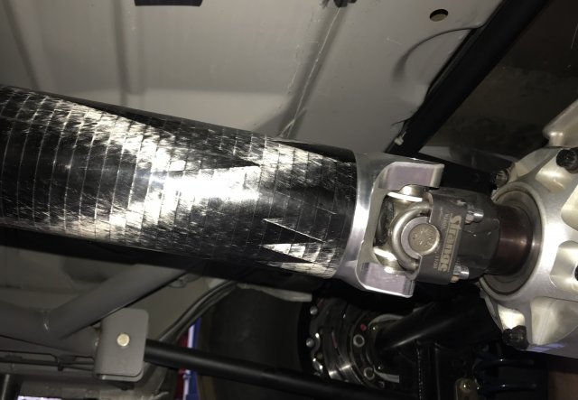

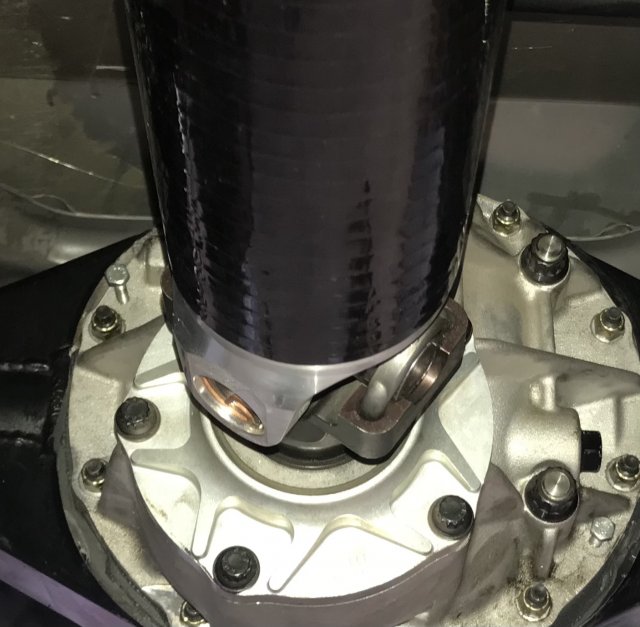

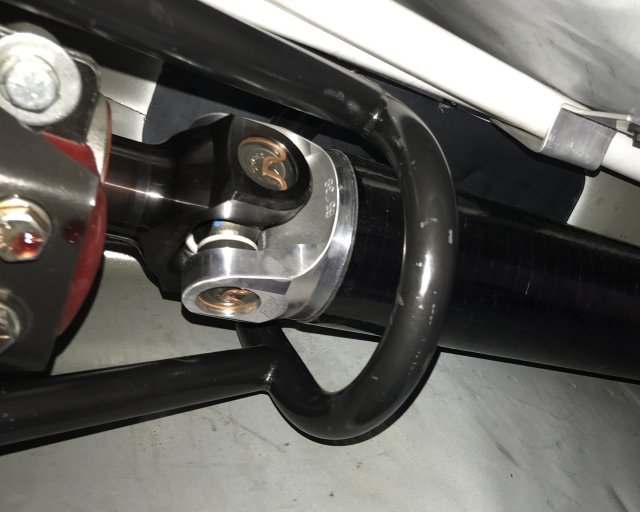

I recently added a PST Carbon Fiber to mine. It’s tested to 2800 lbs torque. The same 3.75” shaft is available for the Hellcat now. The only caution would be that you will need to do a serious job of heat shielding the exhaust if you are running on the street. I think that shaft is running right around $2k. It’s super light and balanced/rpm limit rated to 14,000 rpm. E6561931-A616-43C1-8AA3-088DF4AB8D6C.jpeg 76B8D43F-6181-480C-86EB-4401E51D91CF.jpeg 152C5654-69F1-4918-BACF-4F70EC976D2A.jpeg

. The issues with the aluminum shafts that are commonly used has been unacceptable vibration and on occasion, crappy quality welds that have led to failure. I will guess that the majority are ok and we only hear about the ones that have issues. I ran a DSS for a couple years and in fact ran in the 8,s at full weight with one and never had a problem. You’re in Florida and so is PST. They also have aluminum shafts and would be worth seeing what they have to say about their Hellcat menu.
