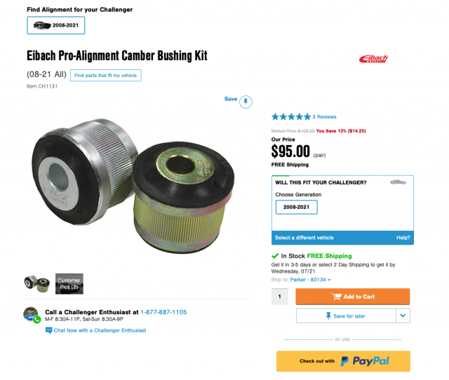

I put a Bwoody kit on the rear of mine but you can save $$ by just installing a set of camber bushings to have some camber adjustment back there.
Thanks! I saw these, but I still want to know why the rear wheel camber is 2.5 degrees vs 1.7 degrees; per the 2020 specs. If MOPAR tells me this is normal for the 50th models, I'd be good with that. I'd still want less negative camber, but I would at least know it is by design. Getting information from Dodge is, well... dodgy.
I have seen those. How hard is it to get out the old ones?
I think there’s a press-on tool shops use.
