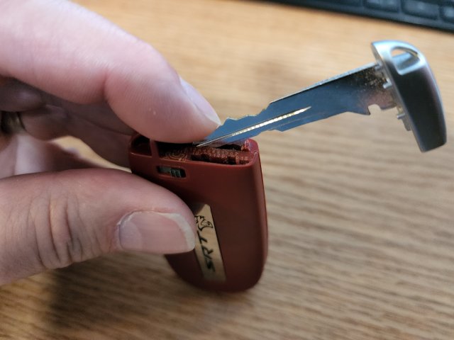

When the battery is low, can you change out the battery yourself without any issues?
Are they 2032's?

Yes and yes. No problem

Agreed, no prob. Do them all at once.

And the manual key that you remove can be used in the notch that becomes exposed to split the two halves easily in half.
