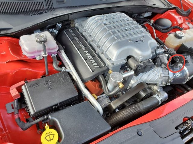

Anyone know the part number for this 90 degree angle plug (red circle in pic)? 2017_dodge_charger-pic-3993521167212486295-1024x768~2.jpeg

For OEM, there are two parts:
5038816AA - Pressure Sensor Adapter - https://www.stevewhiteparts.com/oem...9MjAxNSZ0PXNydC1oZWxsY2F0JmU9Ni0ybC12OC1nYXM=
68224444AA - Pressure Sensor - https://www.stevewhiteparts.com/oem...5PTIwMTUmdD1zcnQtaGVsbGNhdCZlPTYtMmwtdjgtZ2Fz
If you're looking for a replacement for the AFE 90 deg elbow, a 1/2in Black PCV Elbow will work. https://www.zoro.com/spears-elbow-9...MIx4zjqsel5wIVCr7ACh0AUwTBEAQYASABEgK1HPD_BwE

Thanks, I couldn't find anything and the dealer parts department also could not find it.
