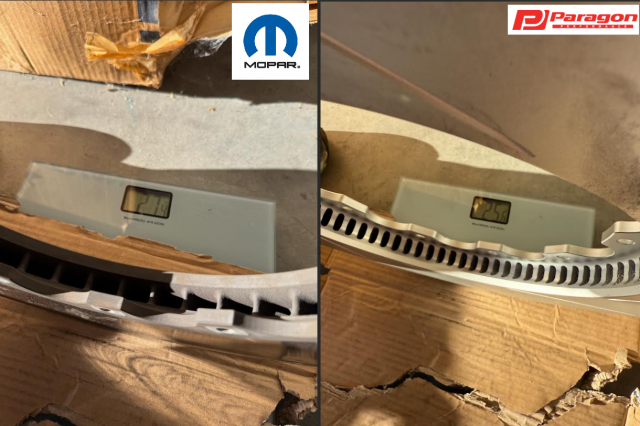

OEM Rings + Hat (est. 31 lbs new and 29.2 lbs worn)
OEM ring: 27.4 lbs (worn, est. +1.8 lbs heavier when new for 29.2 lbs).
OEM hat: 1.8 lbs

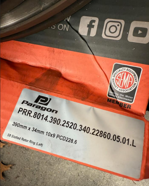

Paragon Dual 2-piece Rotor Front Rings + OEM Hat (est. 27.4 lbs new 390mm and 28.1 lbs 400mm)
Paragon ring: 25.6 lbs (390mm ring)
2015-2020 (390mm): https://paragonbrakes.com/15-4-front-rotor-rings-15-20-charger-challenger-srt-hellcat/) as a direct swap from the OEM hats.

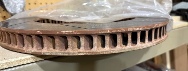

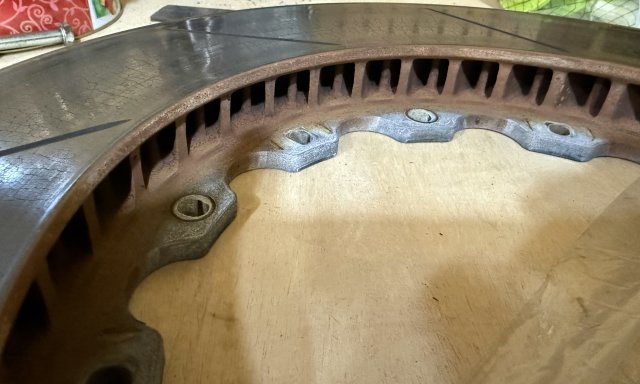

Giro’ outside and inside shots…
16,174
50,677
7,867
49,371
Dude! Where's all that rust from?
: p
HA! Not used in I don’t know how many years. Not since 2019 anyway. Left those for dead because they chattered a bit. I know they have not been on the RE. I think they just need hammered real hard because my current set does that (on the track) if you don’t bust down hard all the time.

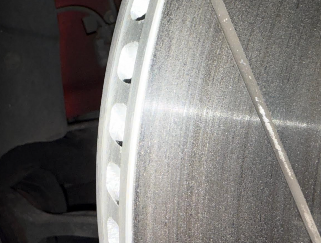

Here are a few more shots.
16,174
50,677
