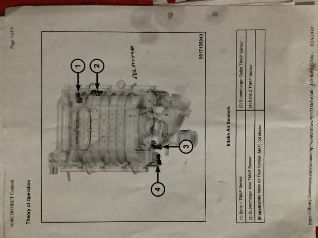

Thanks, I hadn’t seen that diagram.
However, I’m still not sure which of the 4 sensors the code is for... looking up the DTC, it calls out the intermediate TMAP sensor (#2 above). The ‘bank 1’ sensor is called out as #1 in the diagram above. And the Dodge service manual refers to #4 above as the ‘bank 1’ sensor.
I’m so confused...

Diagram says "Theory of Operation". We're not really sure how it works LOL
Well they could prob make it work if it wasnt a theory.

Thread Starter #14
Found this which appears to confirm its the intermediate TMAP. I’ve already got one inbound, so may just replace and see if that takes care of it for now.
