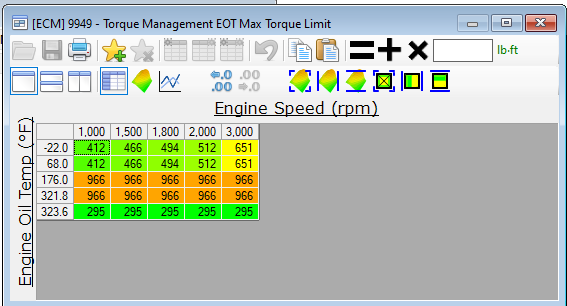

What I was remembering is Engine Oil Temp. Here's the table from HPT for a 2020 Super Stock. I didn't see anything in the trans section that lead me to believe there's temp based tq mgmt there.

I'd think by the time the engine oil got to 176F the trans would be at least "warm"? I usually drive my car to the track (over an hour) so it's plenty warm when I get there but when I trailer to an event I make sure to drive around and monitor both ECT and Trans to get them up to a reasonable temp before making passes.
@jonx96 in case he's seen something in the trans tune for temps.
