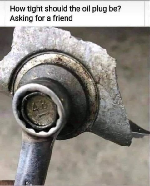

Funny picture,
Not so funny if you are Dyslexic or have had assorted Traumatic brain injury's.. or have a lot of retard in y ha.. If you have the trifecta (all three.)
I always, well 99.99% of the time... hold the wrench in my hand and turn the ratchet. First.
With my previous post, I quoted some vehicles take a very long time to fully drain the free oil. After changing the oil on my old BMW K100. I rolled to the left and started on my 2008 Suzuki B king.. I loosened the drain plug the wrong way. Then I didn't want to remove the oil pan, exhaust /seat ect, ect. So I let it drain..drip for almost two weeks. Then finally I flushed the oil pan with brake cleaner. Retreaded the oil pan, tried some Devon specialized steel putty. On a threaded insert. Let it dry for a few weeks, torqued the drain bolt. Crossed my fingers then refilled it with oil.
