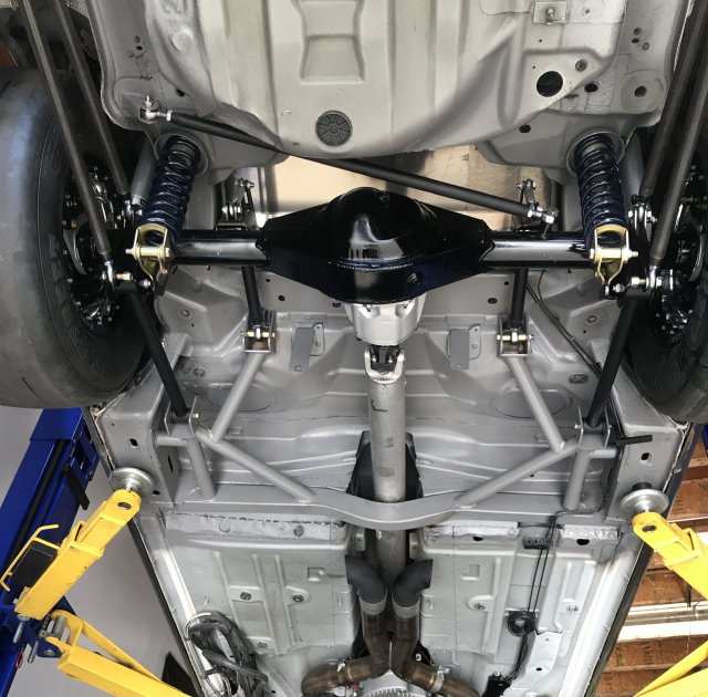

You know what my answer is concerning “the rear end”. If starting from scratch, the DragPak 4-link is no more expensive than the full DSS 9” when the cost of the arms, springs, brake conversion and everything is added up. The one caveat being a fab shop that can do it right and charge a fair price to do it. 46BA04CD-DF38-4286-84F5-E8466992F529.jpeg

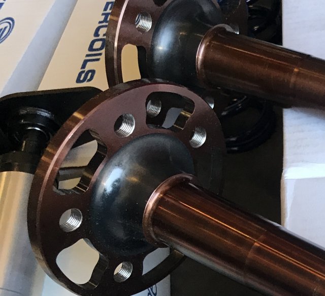

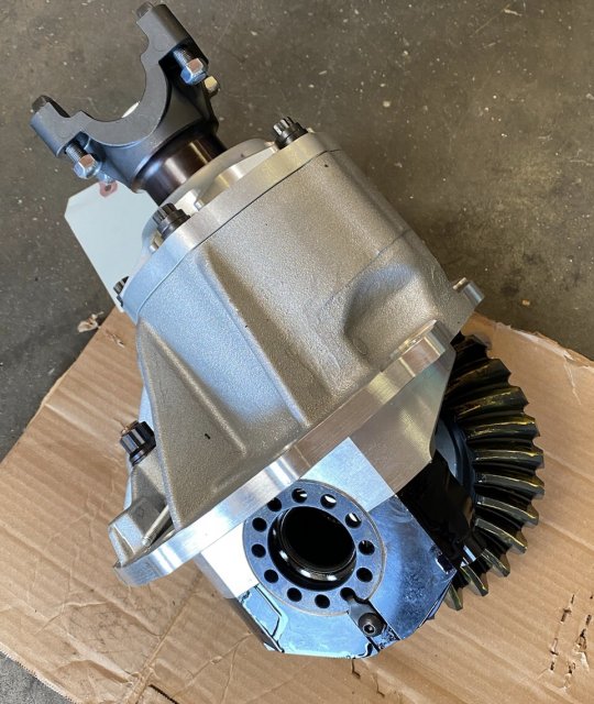

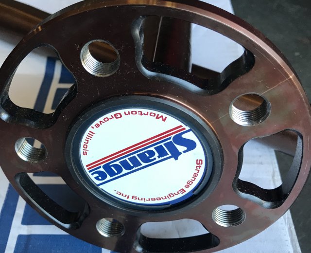

The 9” rears whether it’s the DSS, G-Force or the DragPak all use the Strange Engineering third members. The 35 spline Pro Gear with a spool is going to be virtually unbreakable. Here’s the thing to consider when using that with the hp90.... A second gear launch with a 3.40 rear gear is going to give you very close to the same leave ratio as I’m seeing with my T400. For high powered cars, the too low first gear is the problem. That’s why some are seeing good results with leaving in second with the 3.09. It takes a ton of power and a proper trans tune to really make it work. I think the 3.40 ratio would be better than the 3.09 for most.

No. 2.62, 3.09, 3.70 for OEM. I’ve been running the 9” gears for some time now. First the DSS conversion and now the MPR DragPak. They both use the Strange Engineering third member. I saw that Moser has a nice live axle setup for the Challenger now also. What is called the Pro Gear is available in the 9” and 9.5” sets. Many different ratios including 3.40 available in the 9” and 3.25 is available in the 9.5 thru Strange. I have heard that special ordered 2.75, 3.00 and 3.25 ratios in the 9” can be sourced thru Carlyle. You would have to call them to verify that or maybe someone here knows for sure. The Pro Gear is a 35 spline ring and pinion that is for drag racing. It is “not recommended” for street use because it will wear faster. I run mine on the street and after 500 miles, pulled them just to check on that and couldn’t tell they were worn at all. That was around town driving. I wouldn’t run them on the highway for extended time. That could be a limiting factor to consider depending on what kind of use you expect. As far as the LSD goes..... it’s gone. I use a spool. No spinning one wheel for serious drag racing. The posi is one of the weaknesses of the stock Diff. That and the case. The spool I’m running now is mated to gun drilled 40 spline axles that are a fraction of the weight of the 33/35 spline DSS units and are unbreakable. 1EAE3A30-43AC-42B8-A237-1DA7C645BDA8.jpeg F56F6FB1-D921-4E48-8F6D-555968B273B5.jpeg B0A2BF23-D73B-4AC3-8711-DC844B40F151.jpeg
