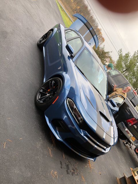

I don’t have any good ones but my wife took this when it was delivered 043DE9B2-1AD8-4F94-8A08-2CF262AD4A3B.jpeg
Congrats on your WB & Welcome to Hellcat Nation !
Post some pics when you can.
Sucks your already having problem, but I have no clue, haven't heard of that one ?
Hopefully you'll get it fixed ASAP.
thanks

She is a beaut! Hope you get issues sorted quickly, enjoy and be safe.

If I were in the market for a Charger Hellcat, that's the one I'd pick! I like the color with the stripes!
