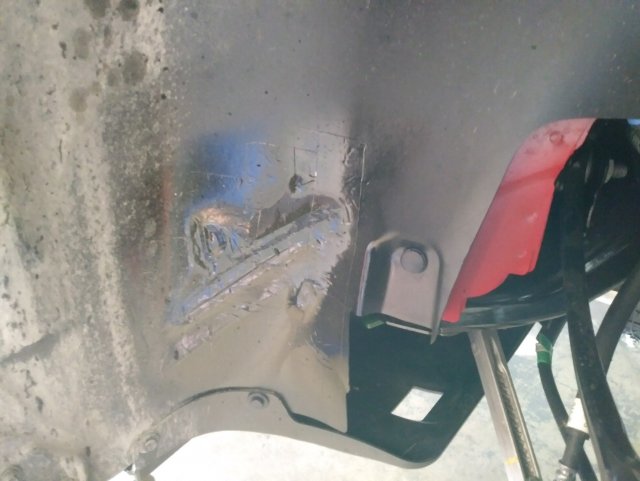

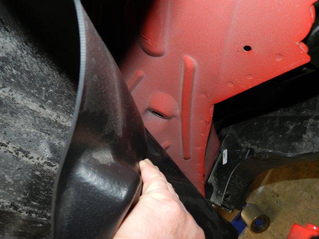

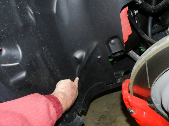

I would double check the back space with a ruler. After that you are going to have to take down that rib. I have done it a bunch of times using different methods. If you don't need much just put some large head rivits in the tub to flush it out with the frame and go at it with a grinder. Plastic, metal and all. Throw some metal HVAC tape over and spray paint it. Simple. No?
View attachment 41224 View attachment 41226 View attachment 41227
Yea, was gonna just take lump mini sledge to it.. 😜
