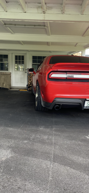

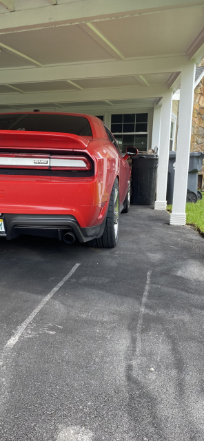

I have a slight negative camber on my back two tires. Originally the rear tires were pirelli 275/45/20 on my 20x10 wheels and I kept the 20x10 but put 295/40/20 on the back, which is causing slight rubbing sounds when I go over medium bumps on the road. Front tires are 275/40/20
im going to a shop Monday to get my fenders rolled to see if that helps. Since I’ll already be there and the wheels will be taken off, should I purchase camber bolts before then and have them install those as well? Pictures below: D4ECFCD7-5138-4664-A609-81CBC62BC272.png F4130654-EAEB-4F89-861A-77FB85962A47.png

What exactly is the camber? Especially on the left, since I can nearly see the camber in the picture.
You sure cannot stand any positive camber. What are you doing to the fender? Where does it rub?

theres red paint on the outside tire wall, so maybe fender rolling might not help. Idk what the camber is on the car because I haven’t checked just yet.
and when I hit bumps I can hear scratching noises where the tire hits near the outer fender.

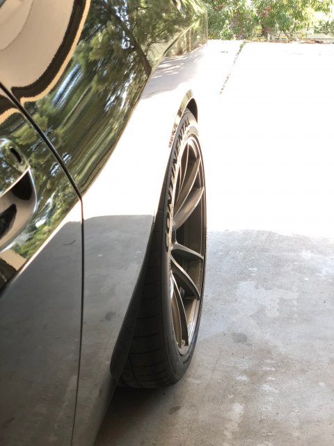

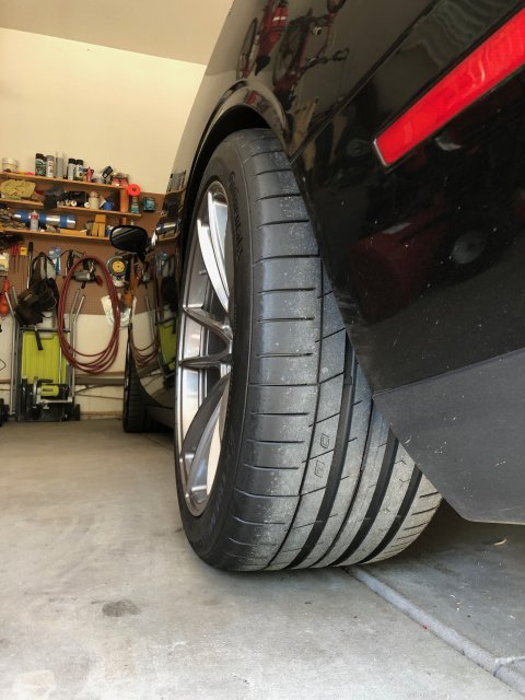

Looks like you’re lowered so yes, I would at least go with a set of camber bushings. Did a Bwoody kit for mine but does cost more. I have 11”x20 wheels with 305/35’s and they align with the fender no more than yours. Wheel offset could be off on yours I think.

the original 275 tires were extremely bald and one was ripping so I went to get the rear tires changed and wanted the bigger nitto 295 tires from discount tire. I think the cars lowered 2” so I initially didn’t think anything bad would happen going slightly bigger, as the 275s made no rubbing sounds at all.
I’m ok with having a positive camber and read that negative has benefits but would just wear unevenly. I haven’t tested the camber since the car hasn’t been on a rack. And the inside of the fender is rubbing on the top of the tires so I’ll have that part rolled to give me more room.
