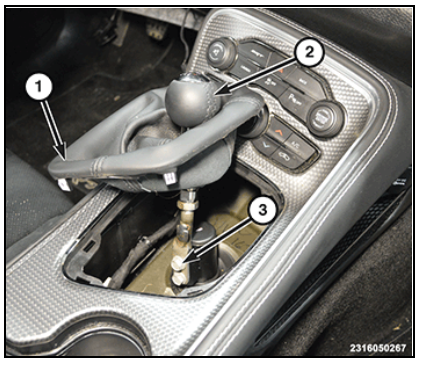

Anyone know the specs of the two bolts that hold the shift lever to the rest of the assembly? I haven't tried to order them from Dodge but I am sure I can pick them up at a hardware store. Figured I'd ask here before I take it to the store and figure it out haha.
#3 in the picture below.

Dealer didn’t have them in stock but gave me the size if anyone needs it:
M8 1.25 x 20
