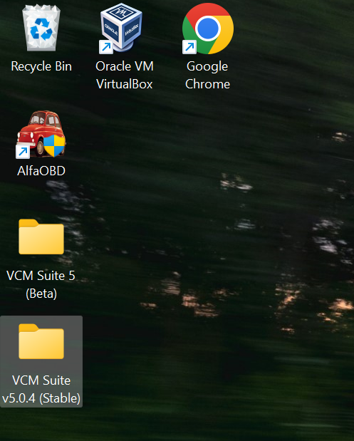

Well this isn't my first rodeo, don't want to use the MPVI3 for tuning anyway and don't need to. Although the MPVI3 will work with beta 4.13. At best it is janky. However I don't want to install 5.x over any of my existing software. Enter my experience as a pen-tester and exploit writer. So the installer is nothing more than a self contained zip file that drops the files into the correct location. You can use 7z to extract the contents to a folder.
Since this is still an archive that would have been installed and renamed you have to rename two files and exactly as follows.
"VCM_Editor_exe" => "VCM Editor.exe"
'VCM_Scanner_exe" => 'VCM Scanner.exe"
I dropped these folders to my desktop and named them appropriately.

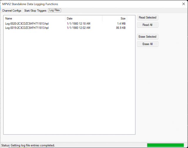

1.) Resync interface.
2.) Curate your channel list.
3.) Vehicle -> MPVI2 Data Logging (there is no v3 menu yet).
* Resync Interface Resources
* Write Channels Config
* Set triggers, I just use the short button press
4.) Plug into OBD2 port, if you can't see the lights you are SOL, I have mine mounted in my glove via an extension cable.
* When you press the button there is a 15-20 second delay before it starts recording. You will see erradic blue light that will switch to a steady on/off blue light.
5.) Drive... drive... drive...
6.) Before turning off car, turn off the recording, hit the BT button once, it will go from steady on/off blue to green.
7.) Take MPVI device from car, hook up to laptop.
8.) Vehicle -> MPVI2 Data Logging
* Click Log Files Tab
* Select log file -> click Read Selected
* Alternatively click Read all
9.) Save to location and do your thing. I opened the log in the Stable v5 branch of VCM Scanner.
