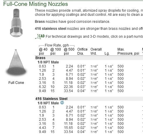

Is the tip of the nozzle like a shower head or just 1 hole? That’s where it’ll turn into a mist vs a stream of meth.
Don't remember been awhile

These worked great for me for years and have a filter screen. McMaster Carr.

Oh shit, I've been building factory automation out of McMaster for years. Now you're telling me that I can buy car parts there too???
Damn, I'm in trouble... :oops:

There you go...your 1 stop shop :)
