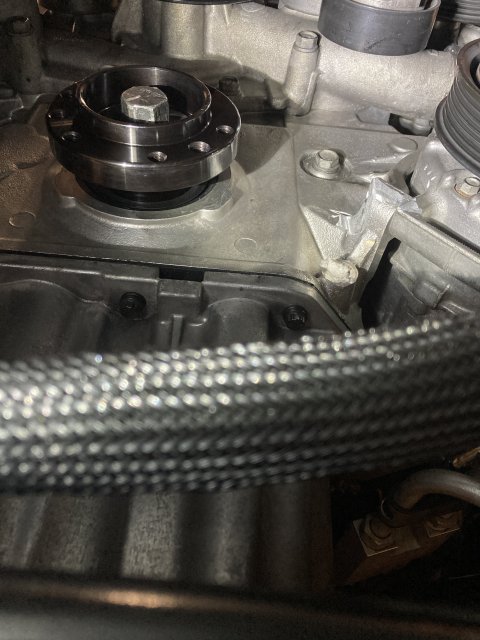

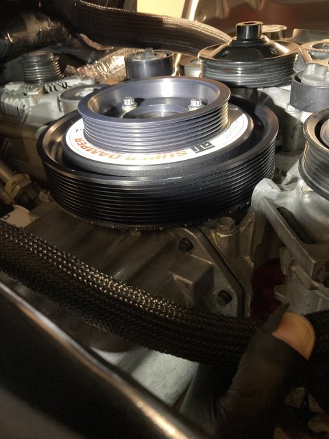

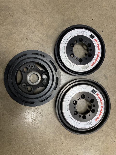

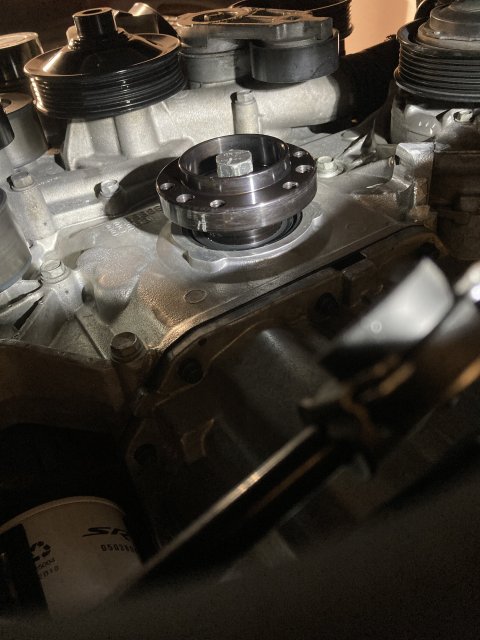

With either, the ATI +10 or the IW+9 the AC mounting boss needs clearanced. Pictured is size difference, stock balancer, stock size ATI, and +10 ATI. You should pin the hub to the crank while your there. You will need a new Damper bolt as well, use the Demon/RE one. E0697EE8-E2F6-4E94-819B-E82D51A24D6C.jpeg E9CBCC16-9CFC-420B-B7EE-756B92EB8260.jpeg AC123A80-FD25-444F-ADA4-02446A99A30D.jpeg 9E0D6D25-9D40-4BFF-9535-2ED1CA4EDFA0.jpeg
