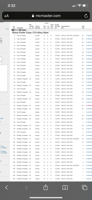

Was looking for some bolts to go with the FI Spacers and can’t find a ton of info online or options. Wanted to see if the 200mm ones listed here would work
That 91290A484 could be what comes with the spacers. $2.41 isn't to bad
I was looking around to see if there was anything else and didn't see anything. Other option would be the 220 and cut them down if need be. You only have 28mm of thread but depending on how deep they can go may actually get more thread in them
I was hoping maybe I stumbled across what they use. The heads on these show 13mm? Does that sound about right?

They appear to be about the same height as the stock ones 7mm
