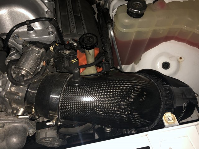

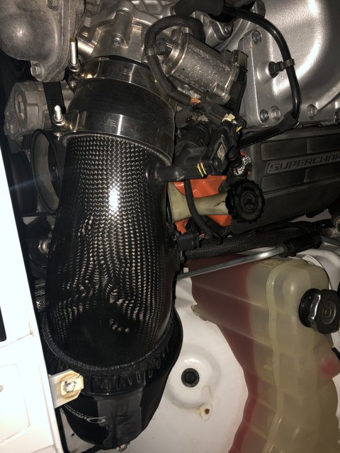

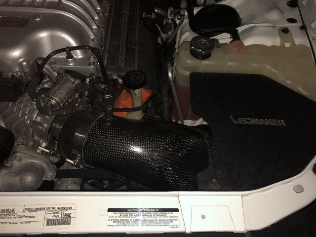

I got it on this morning. I was a little hesitant before about forcing the CF tube any one which way too much because I wasn’t sure how much it would take, but clearly it can handle a little maneuvering. Definitely a snug fit but it’s in. Chris from LMI actually got back to me later last night and said basically what has been posted already, but he was quick about it.
Thanks for the help guys.
