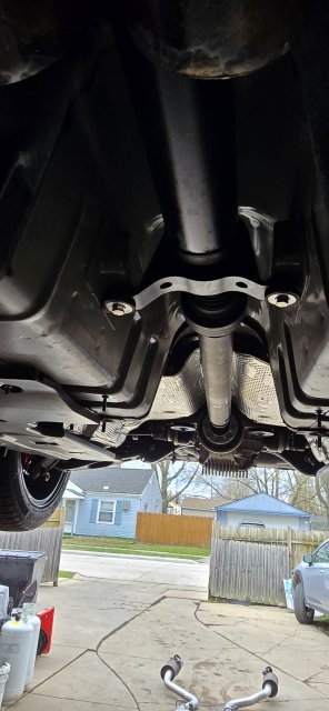

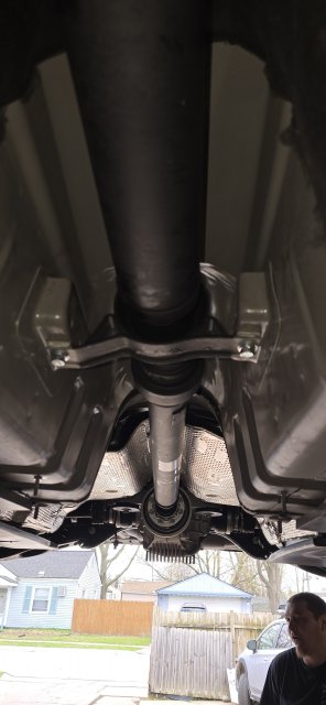

I took pics yesterday when changing to a new driveshaft. The new driveshaft took care of the vibration. However, I think it was from the soft rubber bushings used around the mounting bolts for the JXB bracket. By hand it was moving all over quite freely.
I realize that these driveshaft joints do need some side load on them or they will vibrate more if they are totally straight. I need to figure out how to get pics on here from my phone. Yes, the factory unit is also towards the drivers side, but the JXB visually appeared to be a little bit further to the drivers side. I was trying to figure out a way to measure it, but we were in a hurry and didn't have goofy stuff laying around to put something in place to measure the two. My bad, I am regretting it today.

That was the JXB will try to get the stock now View attachment 163648

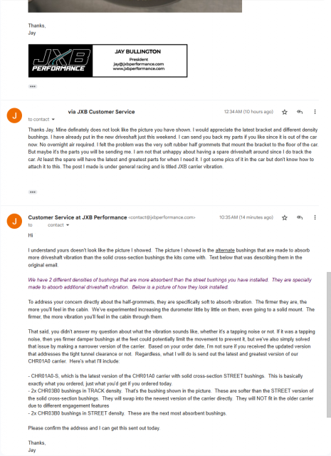

JXB contacted me today with lots of information. They have an updated bushing and a lower bracket that they are sending out. They have a lifetime warranty on their product and it was nice to see the support from them. Glad I got in before the prices went up.
#25755
1
7
Saukville
Owner of JXB Performance

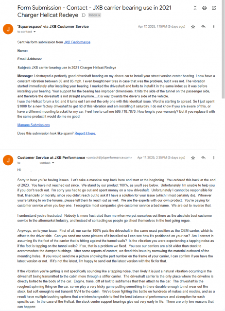

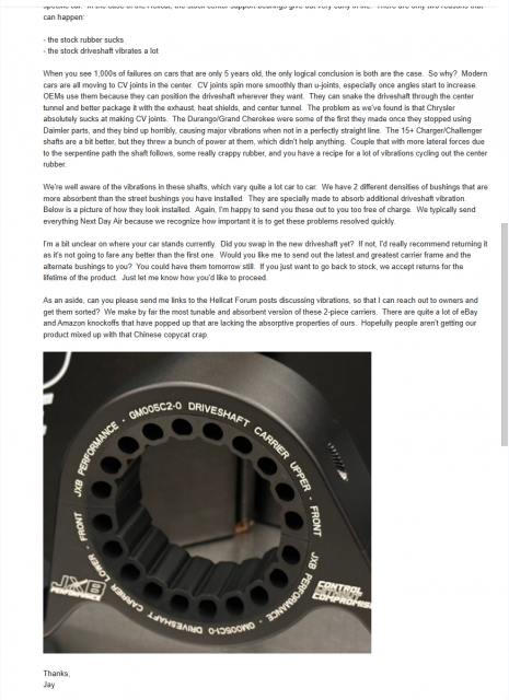

Owner of JXB Performance here. Just wanted to chime in and share our email discussion, so people can see the level of aftersale support we provide and how we stand behind our product. Our entire conversation to date pasted below.
If anybody reading this experiences vibrations with our center support bearing carrier kits, I am an email away at contact@jxbperformance.com. Please do not PM me here or expect a response in the comments; I simply cannot monitor hundreds of different forums. Email is the best way to contact us. Thanks for all the support you've shown Detroitboy and JXB in the comments here. Thanks to Detroitboy for coming in and updating the thread to let people know we didn't leave him hanging.
