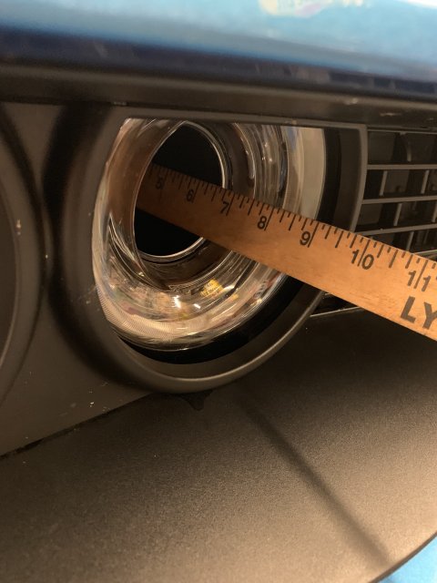

BDE57873-FC45-4F49-AE83-86A735318DBF.jpeg 6941FF6A-2531-4168-9197-65761F17F615.jpeg B0A86341-5447-4763-94DA-00FC90C6DB18.jpeg On the Redeye, the passenger side is capped at the back of the headlight housing. The hole is about 8” deep. The cap can be seen from under the hood.
So its non-functional but if you want to pull the whole front off the car, you can remove two tiny screws (in picture by the white decal) and remove the cap. There is an electric harness back there that may get wet at 200mph in the rain.

Not if you put a deflector.

Before we keep going on about the passenger side headlight.....he was talking about the passenger side scoop itself on the Raisin Bran hood everyone!!

Thanks for the responses everyone, I did originally asked about the hood scoop but its also good to know about the headlight intake too.

As for the headlight hole, the engineers determined air coming through the hole lowered the air flow through all of the coolers and radiator.
The only way to benefit would be to duct it to the air box, then consider how much heat it would pick up getting there. Net loss.
