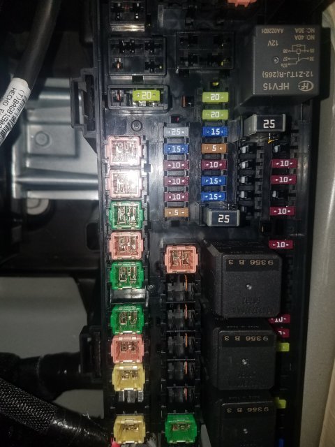

my fuse cover pannel shows f37 and f38 to be fuse 20A. However, my fuse box itself only shows three different green fuses just labeled 20. Do you know which one I’m suppose to take out?
