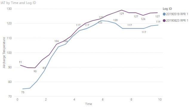

Here are some quick comparisons from the data logs I've collected in similar 90F ambient conditions. The blue line is when I still had the stock supercharger with a 2.50 upper + lower combo with spacers while the purple line is my Whipple with a 4.25 pulley + lower, no spacers. Notice when the ICT starts to climb, it's right around the 9-10 second mark in my passes.
And here were my IATs for the same passes. With the Whipple being purple, it's not that much worst than what I've been able to achieve in the past with the stock supercharger.
I'm quite satisfied with how well my single core Killer Chiller is performing with my Whipple so far. Best of luck to you guys with yours! Hope yall figure it out.
