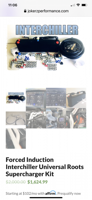

I have a build sheet going.. Was thinking of adding this interchiller in build. Anyone here run this. Any feedback would be appreciated..

I have the Active Interchiller (AI), comes with new a/c lines so no cutting the original ones, 3 way ball valve & digital controller. I like it a lot.

Another note - the 3 way ball valve is for keeping my stock HX's, to switch from the chiller or stock HX, if your eliminating the stock HX's then you don't need the 3 way ball valve. but then you'll need to run the a/c all the time, I didn't want to do that.

Got ya. I would do same way as you, if I do this.

Oh, my kit was $1480 to the door.
But then there's Freon cost.
