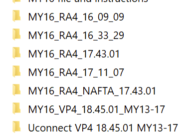

Ref: currently running 17.11.07
(Known releases in my archive)
