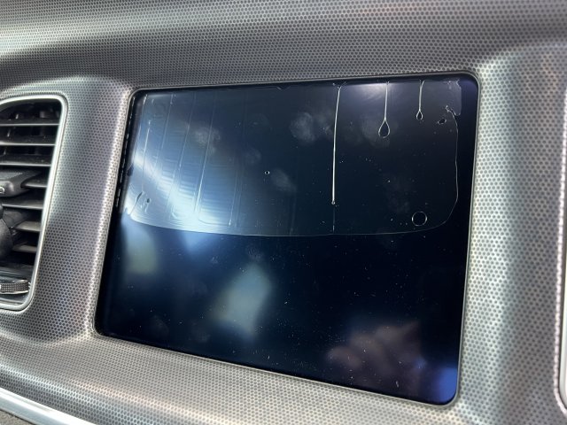

You would need to ask Dodge Cares about that. According to the SR at the dealership I go to they were replacing them regardless of warranty status/miles for original owners. She said they did deny 1 customer who was the 3rd owner of the vehicle. My car was just past the 3/36 and they put it thru without question.
I called Dodge Customer Care and they said no, they would not cover the replacement. Oh well, they did replace my windshield under their goodwill policy when I was outside of the 36k warranty. I figured they would not replace the screen.
For your reviewing pleasure (closer to 60% delamination): 5D4E3230-2AD5-4998-A9F5-85B2B8145222.jpeg
For your reviewing pleasure (closer to 60% delamination): View attachment 77716
Wow, that looks really bad ! Surprised it's still working. Mine had about 1/2" at the top separating & it was making the system go nuts - like it was randomly pressing icons & selecting stuff. It was making me crazy driving around having random crap pop up :oops:
Sheesh, I would have replaced it long ago had it gone crazy like your previous unit…I too am surprised it works fine.

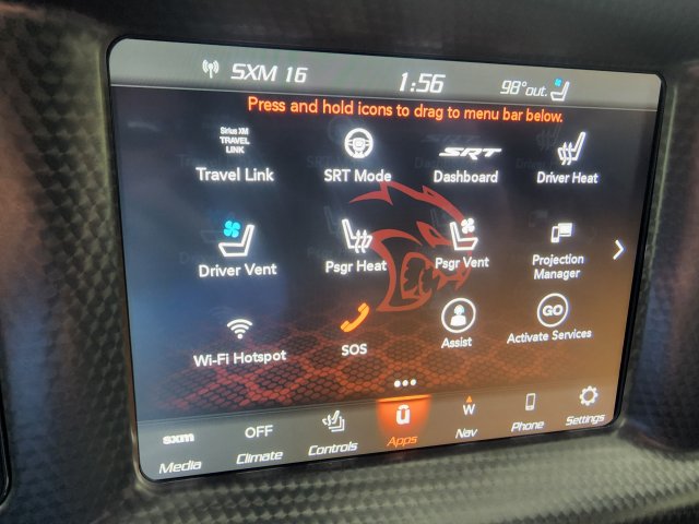

Went to dealer (new to me) today. Tech didn't have to pull anything out...just scrolled and got numbers he needed. Replacement will not be covered under expired 3 year warranty rather my extended warranty with a $100 deductible. Looks like they are ordering whole new unit. Not too impressed with my local dealer but it is what it is.

They were able to get me in today. Took 15-20 minutes. Tech was cool. Looking like a new unit as it has a different feel (much faster)
Mine never had SRT Dashboard graphic.
Looks good.
