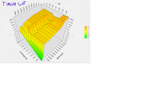

First up here is the timing table. We like to see these smooth. This thing has a lot of up and downs and steep transitions. But this isn’t the worst part of the tune

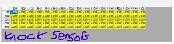

Next up the customer said he wanted a safe reliable tune. Well the knock sensors were disabled maxing them out at 5V

I tried to model my timing table like the factory engineers curve, just raised in all points possible. The 3d graph feature of HP Tuners is underutilized for sanity checks.
Don't get me wrong it doesn't have to be perfect and they can be shaped slightly different. Even factory isnt perfectly smooth. But it doesnt have to be. You just don't want the pic above.
