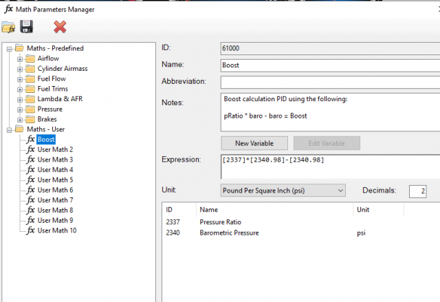

That's what I did, only to get a little more accuracy I used the formula:
Pressure Ratio * Barometric pressure - Barometric pressure
@Speedy! What symbol do you use for Multiply the Asterix? * ?
Here’s it by IMAP
7,607
19,940
Yep asterisk

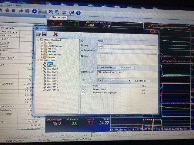

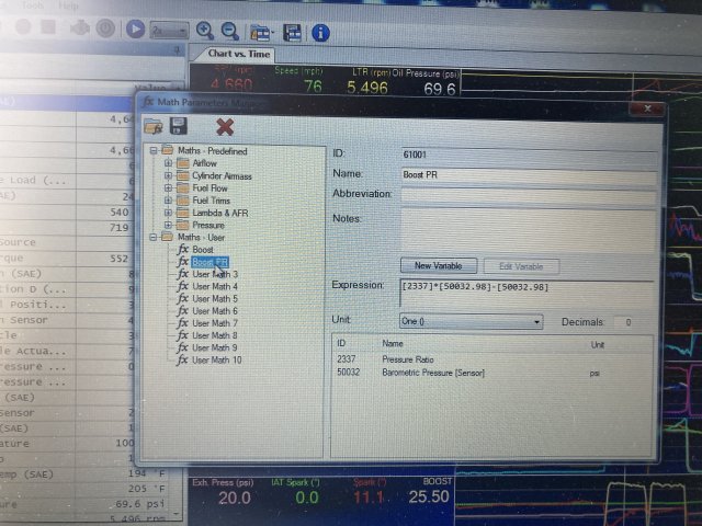

@Speedy! can you post a screen shot of your math page for boost based or PR? I can’t get mine to work that way.
See mine, look right or wrong PR channel?

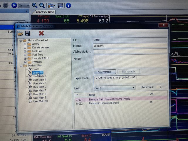

@Speedy! I found the PR pid but I ca not find the Baro pid you used, I used sensor. Where did you find the Baro pid you used? I’d like to be comparing to a same calculation as others may be using to get an idea how this 2.7 is doing boost wise with my custom plate on it and hand ported snout with a 105 TB

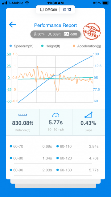

Boost using above pids. 25 psi avg on the pull not bad for a +10 lower 2.74 clutched upper combo with a well used belt. From watching the boost pid I think there’s a hair of belt slip going on, may install a new belt before dyno visit.
Going to dyno the car soon to compare to previous blowers, ported 2.4, Whipple 3,0, and Whipple 3.8.
It did good on a 60-130 pull on the Mexican border crossing bridge Sunday am. Cold roads yet but the 305/35-20 half tread Conti’s did good yet.

You should be able to search for the PID by number.
